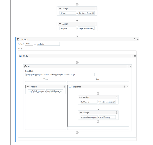

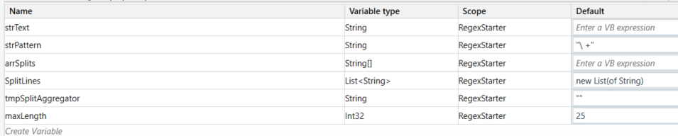

Please find the solution attached. I have taken the example on the screenshot and wrote it from A3 incrementing the cell count. You can do string manipulation according to your requirement and modify the solution.
Write Cell: The length of the string cannot be zero.
Parameter Name: oldValue
