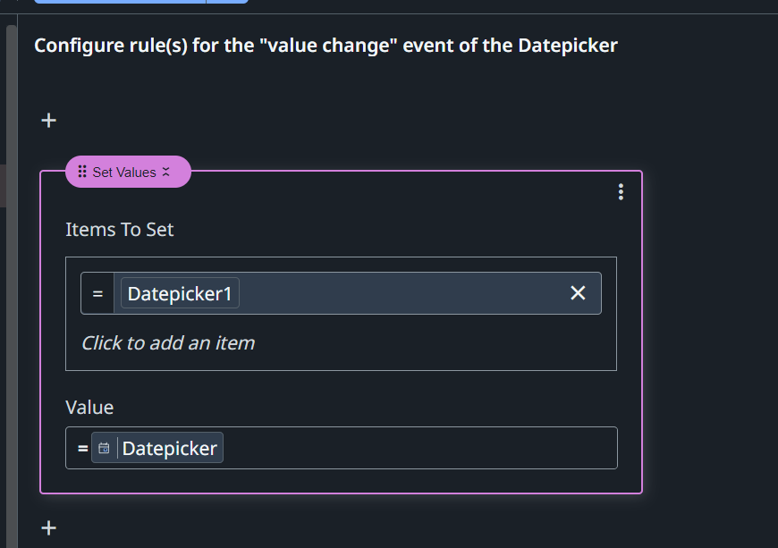

Yes you can do this, To do this you need to write a rule on control to set value as below.
  1. Go to your control production start date and configure a rule Item to set and in the configuration Item to set should be Production start date and in Value Production date
  2. Similarly you can for Selected machine
Please have a look at below configuration.
