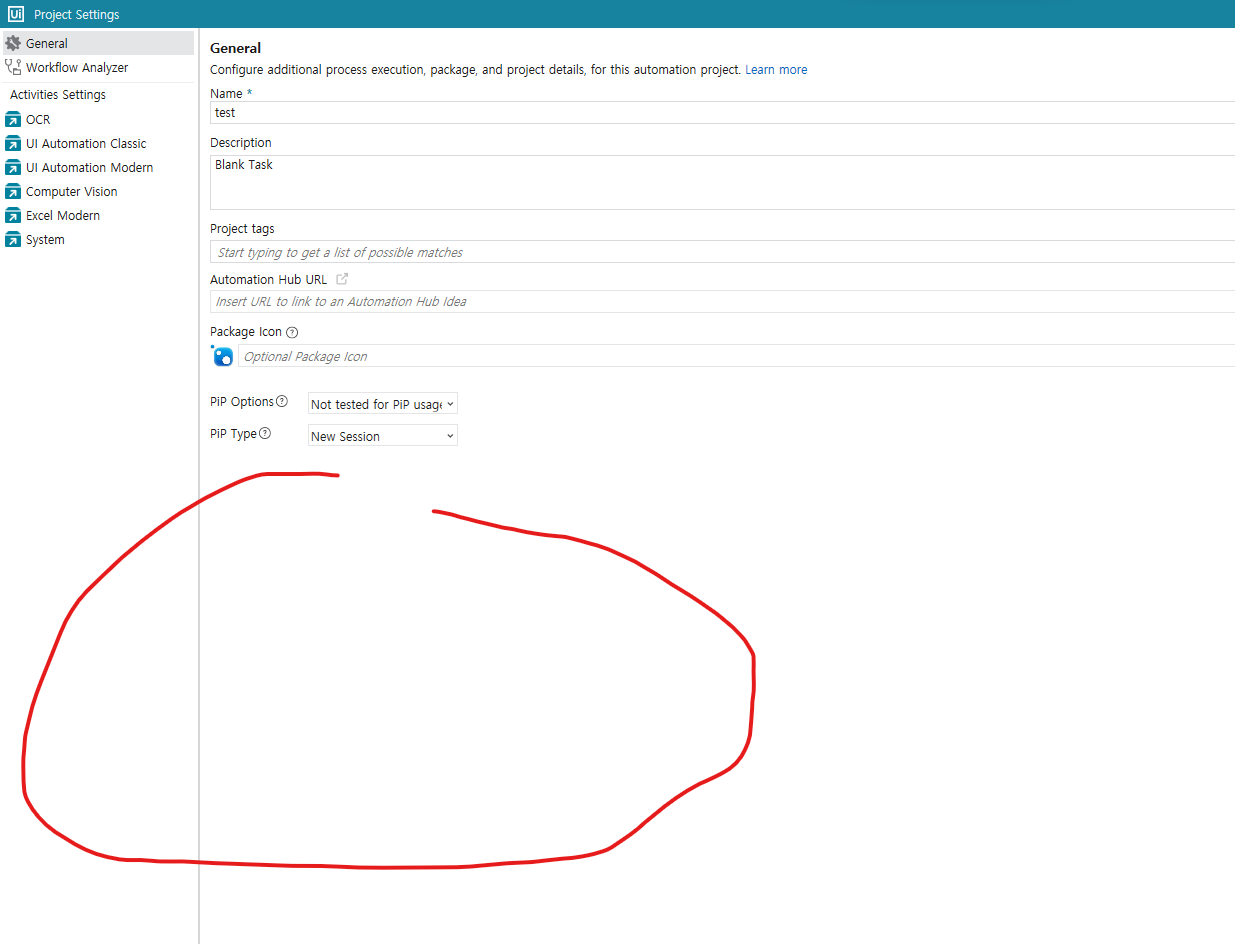

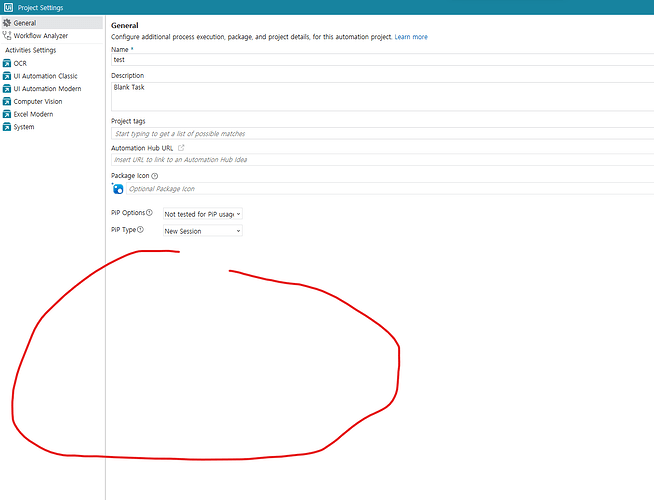

Dear Yoichi,
I have only one option when publish as below picture,
HI,
Which license do you use? If AutomationExpress, you can use only personal workspace
If use other license, can you try to add role as the following post.
