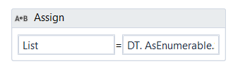

I did this.
  • reading the excel sheet. (the table exists on the database, but I think the operations are identical)
  • LIST variable assignment
List = array of objetct
but, if i try to write list:
I thought I could see the list of dates, grouped?
Did I do something wrong?
I’m not very experienced … sorry
Use write line in foreach item in List and print item.Tostring.
Else in write line use this String.join(“,”,List).
