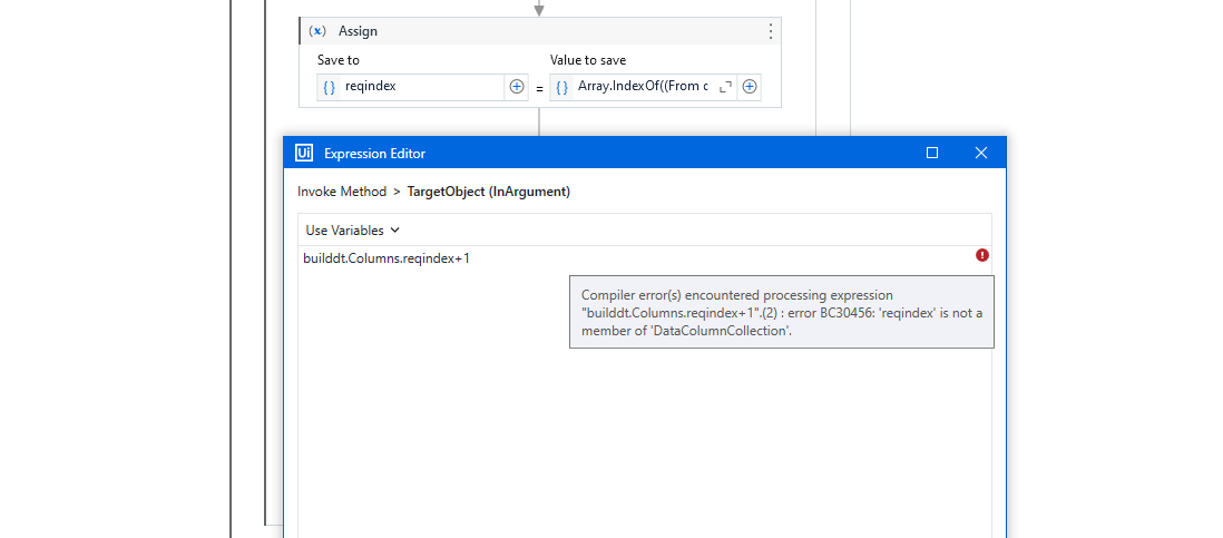

Requiredindex = Array.IndexOf((From dc In dt.Columns.Cast(Of DataColumn) Select dc.ColumnName).ToArray(),"RequiredColumnName")
how should I mention in the invoke method
after the assign method
@anjani_priya
What is this .reqindex …you just need to specify the requndex +1
And pass the datatable to invoke method…please check here
