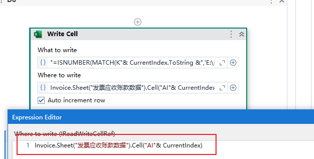

Dears,
There is no value under the process below.
I used the message box to test the expression“Invoice.Sheet(“发票应收账款数据”).Cell(“AI”& CurrentIndex)”. It will show a value but not an address.
Is there a method to solve it?

Already which is there in your cell is the address …
Address is "AI" & currentindex
Or
Append .Address at the end and you would get the same value again
Invoice.Sheet(“发票应收账款数据”).Cell(“AI”& CurrentIndex).Address
Both would work

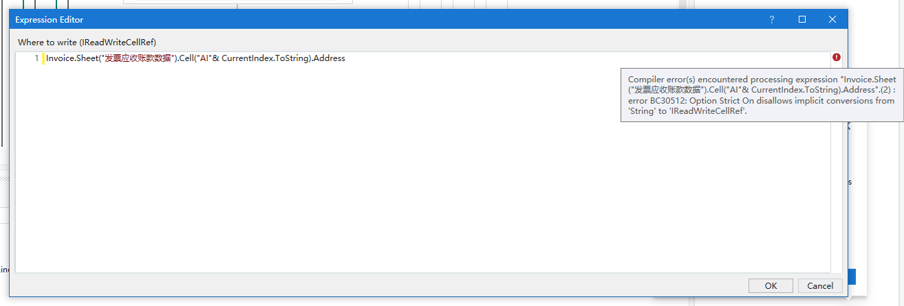

Invoice.Sheet("发票应收账款数据").Cell("AI"&CurrentIndex.ToString)
Cannot get the output
There is warning like this.
@jackie.yue
In that field you should be provided only till cell…no .ToAddress…
You can add address if you want to find output which address you are using
