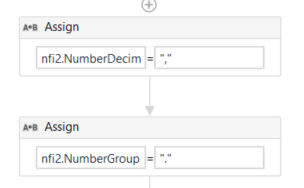

@AaronMark
You can Parse it with taking control over numberformat info / Culture Settings (lets ignore EUR so far)
first Price is in a form of default format
Second Price is common in Germany, France…
Have a look here
grafik
grafik
It is suggested to parse it into Digit related Datatypes to avoid sideeffects and to be prepared on computations e.g greater / smaller checks, additions …

@AaronMark
Can you have a look to my screenshots (watch, Variable)
  • create the variables
  • do readin both excels
  • in e.g. an if activity you can compaire both type of amounts by using the conversion functions as the syntax is in watch screenshot.
also you can try with a test sequence create two strings with amount within the 2 type of valueformats
do within an if a compair on the two converted boolean using the conversion functions
message Boxing true, false and explore the topic practical
Incase you get issues within your modelling we are here to help and can also have a look on your XAML

@AaronMark
Have a look and play with this demo
AronMark.xaml (6.5 KB)
it seems to work.
