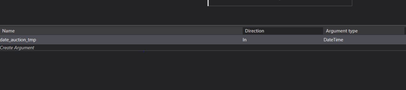

Hi @Rhys18
Check the date_auction_tmp data type it should be DateTime Type

Changing from string to date time is working but other variable is having errors. Can it just be string var only?
