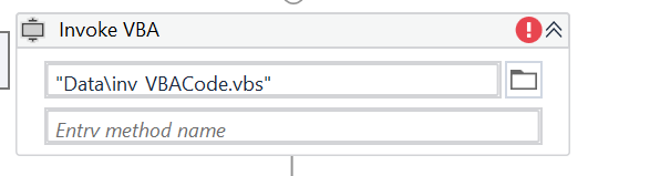

what to put in entry method
i am trying to run VBA manually , i got error
@RAKESH_KUMAR_Tiwari
Give the function or method name in the name field…
Eg:
If the vba is as below then method is test
Function test(Target As String)
 Range(Target).RowHeight = 0.75
End Function
