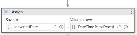

It is strange. Could you check these expressions:
@Gokul001
That’s strange. The date format in my computer corresponds to the Brazilian pattern. Does it make a difference is this case?
If i try like this its working for me also @Konrad_Mierzwa
So the cultureinfo works correctly in your case. I have no idea why this previous expression throws an error for you. That’s really strange
