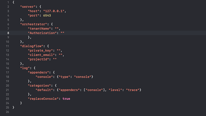

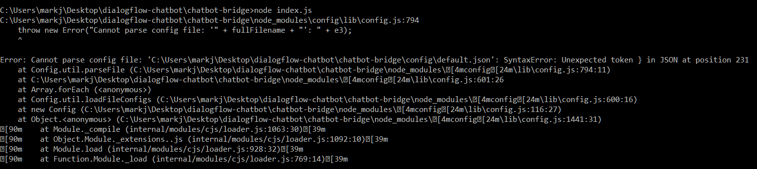

Hi, I believed I have set up the config.json properly but I receive this error
@Mark_AJ,
This issue is because error while reading the config , check config so that value is of string type , check for parses.
If not solved share your config I’ll check .
Okay so it was a parse error my bad, it was included in the code provided. But now I am having this error
