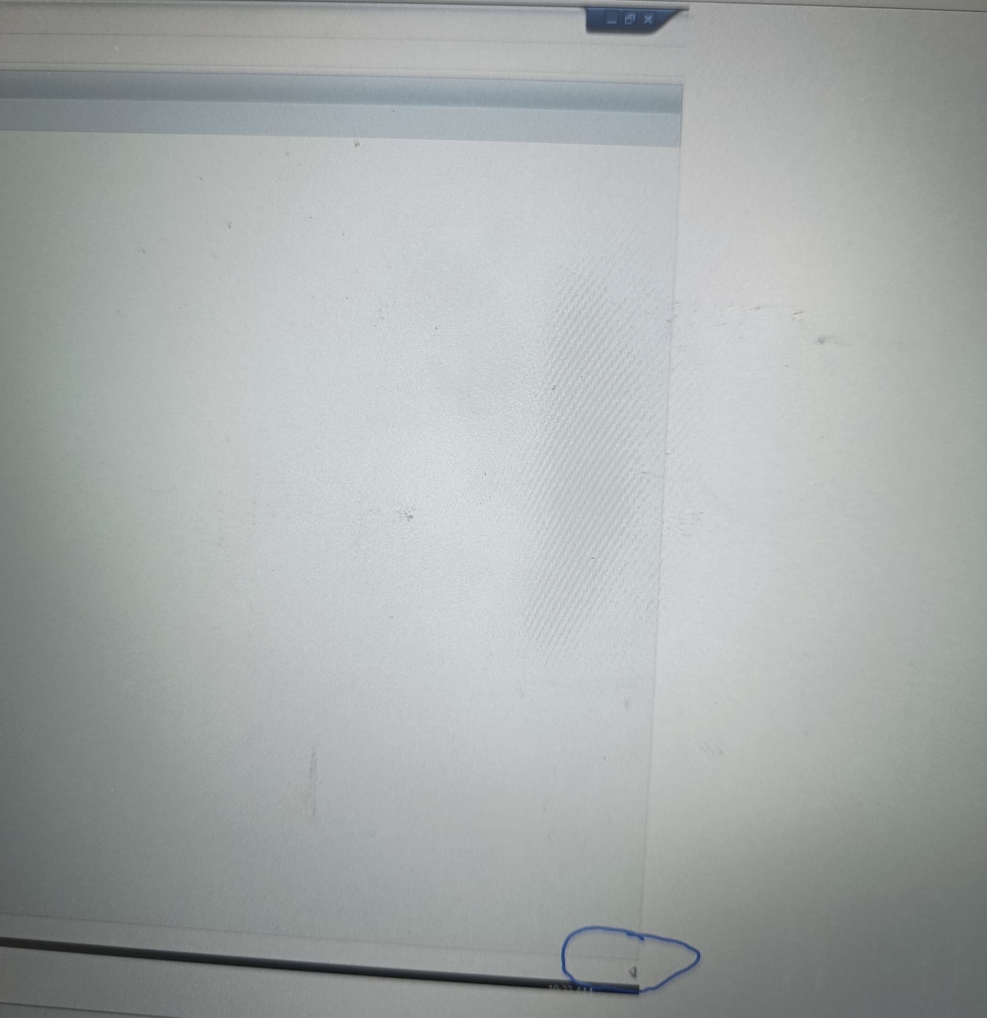

Is anyway to click the status bar button in the SAP. Is any hotkey present. While selecting it’s taking full selector. I can’t use click i
mage.

@brindhaseran1503
Can you show clearly what you want to spy?
Is it part of the SAP WIndow or inside SAP?
cheers

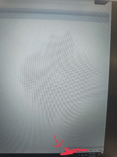

It’s in the footer it’s like the slideling. While selecting it’s taking full footer selector. I have to click that sidebar to get system details.

@brindhaseran1503 you can get the details of that with SAP connection properties. If allowed, you can use VBS to retrieve that.
Actually i have to take screenshot of responsive time. is anyway to click that sidebar
