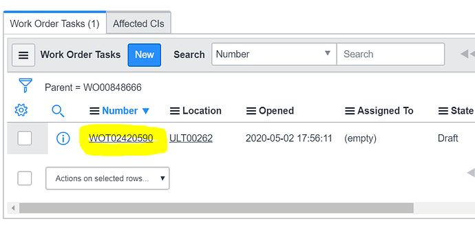

I have to click on hyperlink in a webpage. The name of the hyperlink keeps on changing but the position of the hyperlink will remain same. How can click into it ignoring the text?

Use the wildcard character * in the selector .for example if aaname=WOTO2420590 ,use wildcard character like aaname=*
You can use wildcards(* or ?) depending on your situation.
Moreover, you can use UIExplorer to fine tune your selector.
Else, try implementing the concept of dynamic selector. The tutorial for it is available in academy.

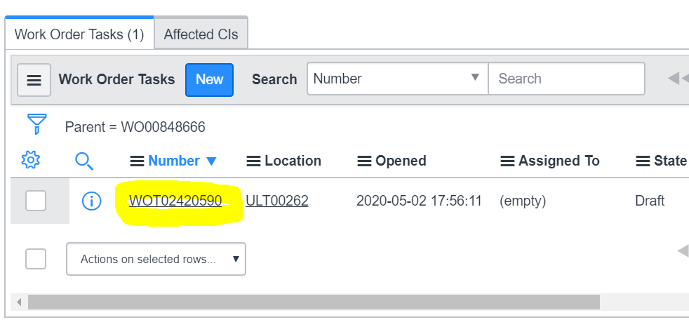

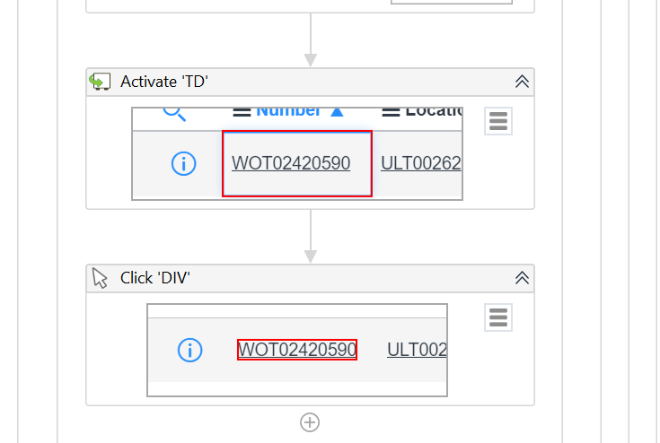

I have tried using wildcard * but the click activity is working on different position than the mentioned.
Please see the screenshots below and let me know
Also, I have used activate activity and the used click Activity.
Could you please try with Click Image or Click Text Activity along with attach browser activity?

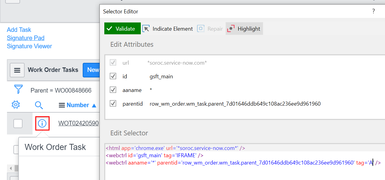

I used UIExplorer and to select row,column locations and enter wildcard(*) as parent id.
It worked fine!

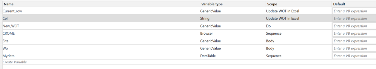

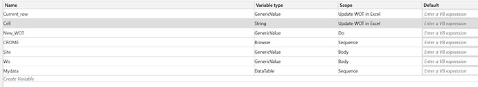

Current_row = Mydata.rows.indexOf(row) + 2
Cell = “D”+Current_row.ToString
is there a problem with variables?
Change the variable type of generic value to appropriate type(String).
Generic value should not be set as it is not a good practice.
