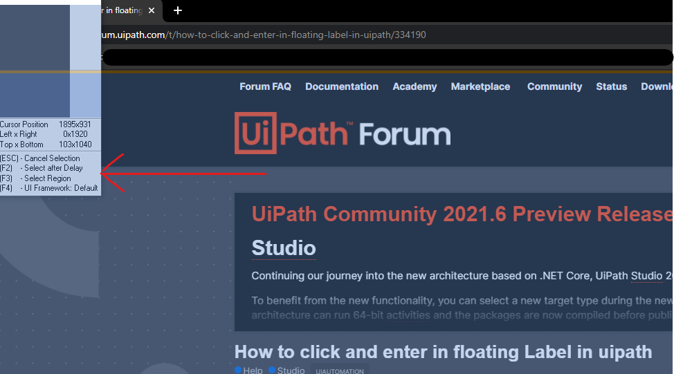

  3. Use the ‘Select after Delay’ feature when using Indicate Element on a UI activity. You can delay by keyboard shortcut “F2”.
