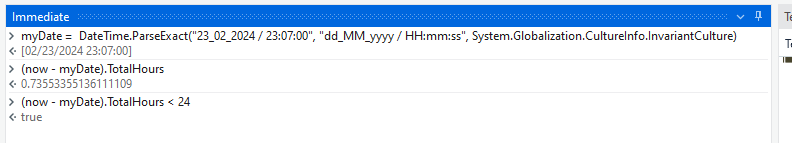

dateTimeVar = DateTime.ParseExact(strDateTime,"dd_MM_yyyy / HH:mm:ss",System.Globalization.CultureInfo.InvariantCulture)
then check
Now>dateTimeVar.AddHours(24)

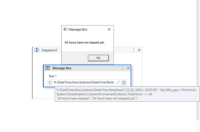

Try this:
Output = If (DateTime.Now.Subtract(DateTime.ParseExact("23_02_2024 / 23:07:00", "dd_MM_yyyy / HH:mm:ss", System.Globalization.CultureInfo.InvariantCulture)).TotalHours >= 24, "24 hours have elapsed.", "24 hours have not elapsed yet.")
Hope it helps!!
