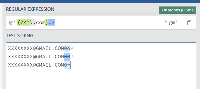

@chandolusathi.kumar ,
Could you maybe try using the below regex Expression :
(?<=\.com).*
System.Text.RegularExpressions.Regex.Replace("XXXXXXXX@GMAIL.COM00","(?<=\.com).*","")
Let us know if it doesn’t work.
