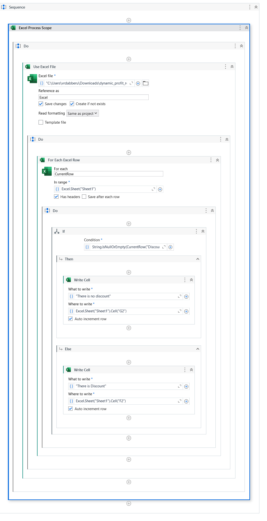

Hi @Hayashi
Please check the below workflow
Don't forget to change the option in For Each Excel Row in properties panel from Stop to Process.
Xaml for your reference:
Main.xaml (19.1 KB)
You can use the below workflow if you want to handle with data table’s
Main.xaml (26.2 KB)

@Hayashi
Not String.IsNullOrEmpty(CurrentRow("Discount").ToString)or Not String.IsNullOrWhiteSpace(CurrentRow("Discount").ToString) or CurrentRow("Discount").ToString.Contains ("Off")
Hope it works

Thank you actually both method works.
