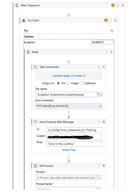

I have added try and catch by adding take screenshot modern activity in the catch. But if any error occurs, I’m getting the screenshot of UiPath screenshot instead off the screen where the error occurs

This is my catch flow
If you are using any single application use indicate element for Take screenshot activity.

@anjani_priya You can refer TakeScreenshot.xaml of Re-Framework.
In case you are running process in attended mode or debugging it will take screenshot of window present in front.

hello @anjani_priya
I think its because your workflow has activity with property of Simulate Click/ Type into
try without using simulates and let me know if it works.

Hi @anjani_priya
In the Catch block, use the “Take Screenshot” activity from the UI Automation package instead of the Modern activity, as it captures the actual screen. Set the screenshot output to a variable and then use the “Save Image” activity to save the screenshot to a file or log it. This ensures that you capture the screen where the error occurs, rather than the UiPath robot’s screen.
