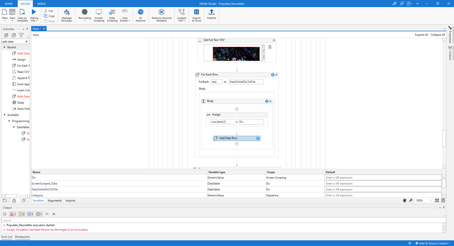

I have a CSV file that opens in excel. It has 5 columns, but i want to another column after the 5th one.
How is this achieved?

Hi happygal!
I think you can follow the following steps:
–> Use the read CSV activity and save it to a datatable variable
–> Now use the ADD DATA COLUMN activity to add a new column to the datatable
→ Perform the operations you want and save this new csv
I hope it helps!
i tried this, but it didnt work. could you show an example?

@gabrielribas4 method works for you @happygal321
check this workflow
process1.zip (4.2 MB)
