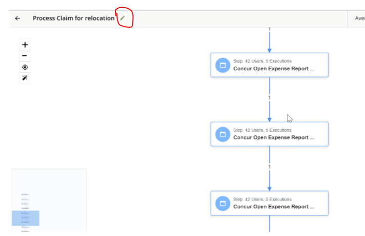

Additionally on THIS site you can see that it can be edited:
Thanks Pablito, we are on the same page, basically Analyzer AI define task & step name it can be changed manually. In that case, is it able to add new rule to Analyzer to classify each step? For example open specific URL will be named “Finance activity”. if you know something nomination detail please let me know.

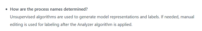

I finally found my answer in FAQ. it says we must use Analyzer AI and if the given name is not acceptable, we need to change the name manually & one by one.
Thanks @Pablito for your help.
And please correct me if my understanding is incorrect.
J,
You’re totally right :slight_smile:
