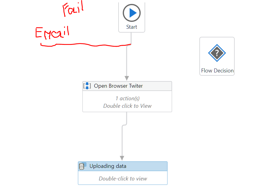

Thank you @ermanoj3101 ,
can it be possible see above image.
Put this workflow in try catch and if this is your parent workflow send mail in catch block.
