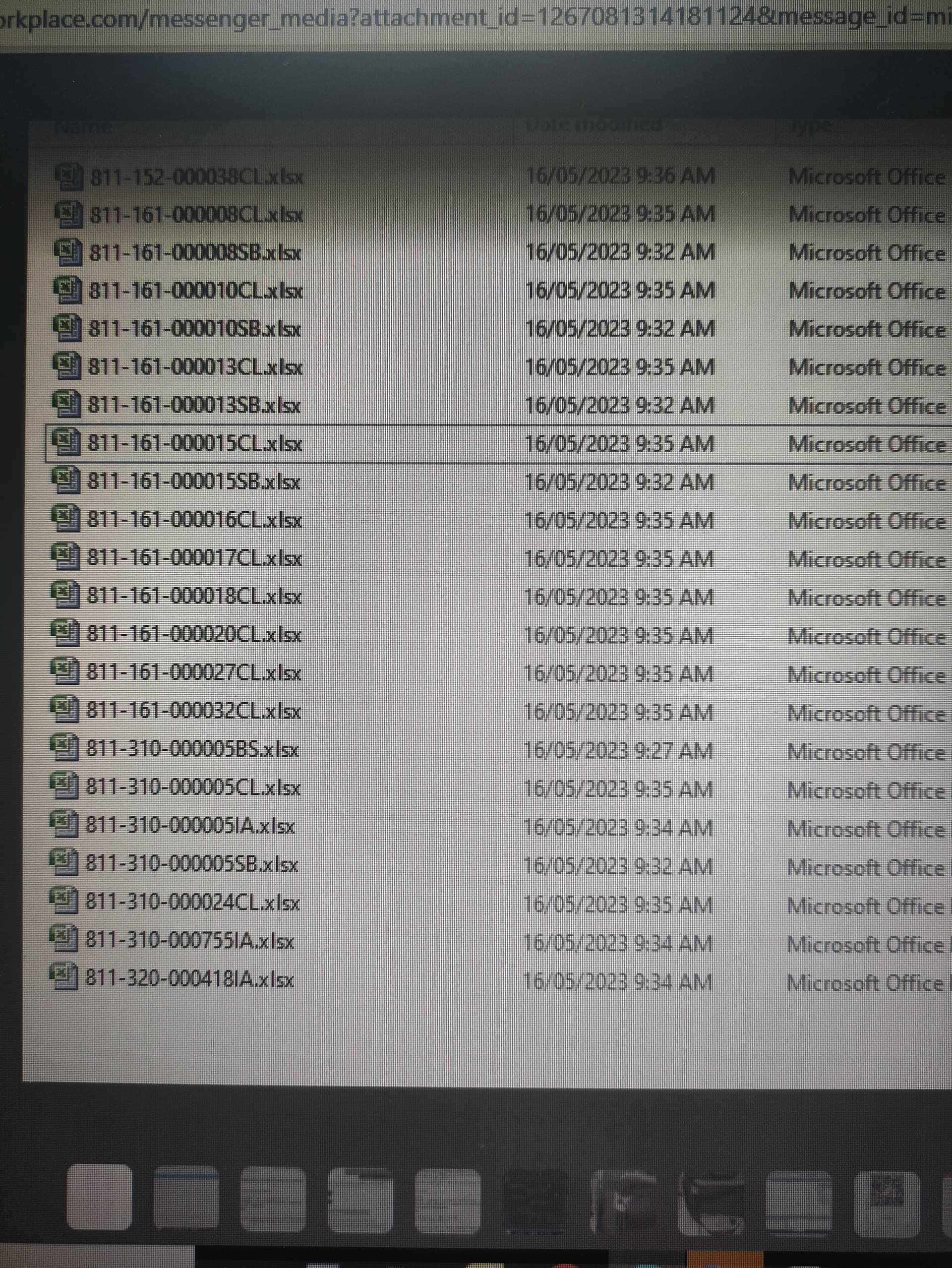

Hello Guys, how can i select or group the files that is similar number but only different on the last letter of the file name
Thank you so much
For your reference here is the picture
Thank you so much
You can read all the filenames and use a regular expression to match every group of files. If a filename matches with the regex of a particular group, you can process that file to that particular group. Otherwise, you need to check the remaining regex for other groups.

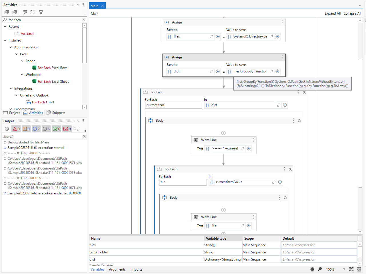

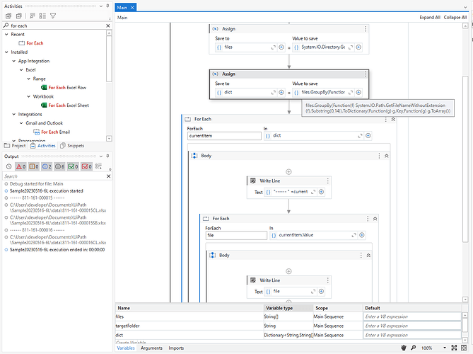

The following is a simple sample for grouping with first 14 characters in each file name. Can you try this?
dict = files.GroupBy(Function(f) System.IO.Path.GetFileNameWithoutExtension(f).Substring(0,14)).ToDictionary(Function(g) g.Key,Function(g) g.ToArray())
Sample20230516-6L.zip (18.6 KB)
Wow thank you so much, it works for me
