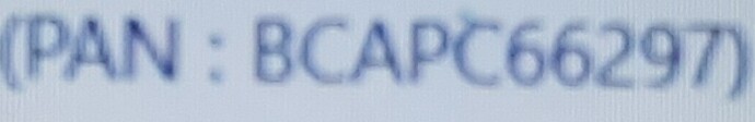

@Shubham_Kinge i used ur method but it is not getting highlighted…I want like this i have sended you in the above image…only PAN should get highlighted…in the mail body

Bro i want the output like above img…In this case user will run the bot 2 times a day and basically bot will download multiple pdf’s extract that pdf’s and then it will convert that extracted pdf’s in txt file, after that bot will append all the extracted pdf’s in mail body and in some text (PAN:JECPS8***) Pan no is written and in some text Pan is not mentioned…I just wanted to highlight that PAN-JECPS8******.
@Shubham_Kinge iam not getting the ouput it is showing color:red it is showing ouput like this

it is because Pan card may be in lower case or something. can you provide what type of pan numbers you are getting. styles not real pan like
KSJDK1234K
kkdjs1111k
KkKk2313j
Like thins?
cause i sent regex for Just matching Upper case 5A-Z then 4 0-9 and 1 upper case Word
[A-Z a-z]{5}[0-9]{4}[a-z A-Z]{1} provide this for above examples
It is in upper case only
Bro again i got the same error
[A-Z a-z]{5}[0-9]{4}[a-z A-Z]{1} after using this also i got the same error
okay then try this one.
[A-Z]{5}[0-9]{4}[A-Z]{1}|[A-Z]{5}[0-9 A-Z]{5}
because pan having one last Alphabate not number thats why error came
