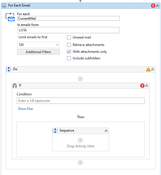

In the meantime: i am trying to use “For each email” activity instead of “For each”
to know if for each email could allow me to fix my filter problems
but it said i need a king of outlook account card…
Thanks for any suggestion of knowing what it means outlook account card…
@Ricchch
First of all you can use the additional filters on the for each loop for most of your cases…
Is the same filter you are looking as condition in outlook card?
