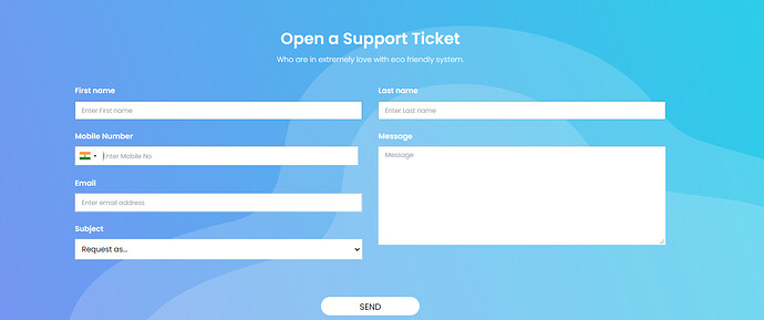

1.In our Company some requirement is there like I Have a support ticket form on our website when User come and fill the data in the form we have to send a support mail to him and our company manager whenever the new data come we have to send the data to manager and support mail to the user How to do anyone tell every time how we run and how can we get to know or how can we know the new data come to the database
