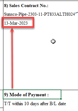

I use LookUp to find dynamic cell and + - number if the value is known how many rows to look for.

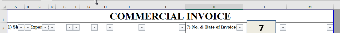

I want get the value cell (13-Mar-2023) upper dynamic cell (Model of Payment) but I down’t know how many empty rows. how can get this value
DLV010 - Copy (1).xaml (14.0 KB)
@anh.nguyen
After reading data try filtering the column with empty …and then they would be side by side…so find mode of payment and then immediate top row would be the date
cheers
Hi
I can find “Mode of Payment” ? at K16 → K column

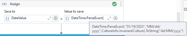

Try this,
DateTime.ParseExact("01/19/2023","MM/dd/yyyy",CultureInfo.InvariantCulture).ToString("dd/MM/yyyy")

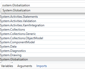

Note : Please Import System.Globalization

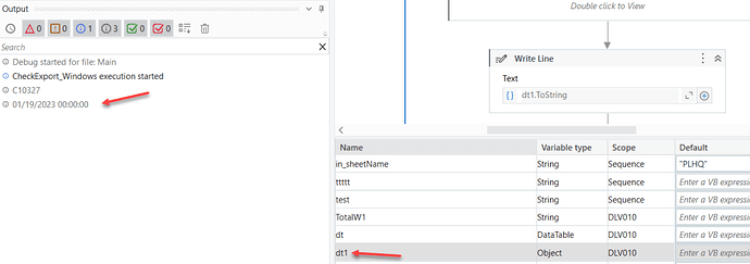

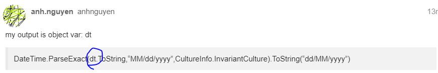

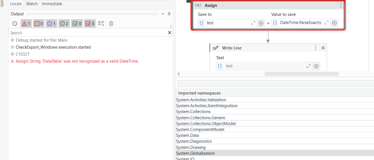

my output is object var: dt
DateTime.ParseExact(dt.ToString,“MM/dd/yyyy”,CultureInfo.InvariantCulture).ToString(“dd/MM/yyyy”)
o
@anh.nguyen ,
I believe dt is your data table right?
Actually you have to mention the date value there which is in MM/dd/yyyy format.

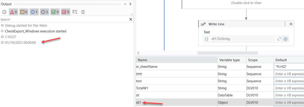

Yes, output as pic, now i want change to dd/MM/yyyy

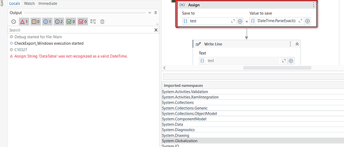

@anh.nguyen ,
Please provide dt1 instead of dt here
Try like this,
DateTime.ParseExact( dt1,"MM/dd/yyyy hh:mm:ss",CultureInfo.InvariantCulture).ToString("dd/MM/yyyy hh:mm:ss")
