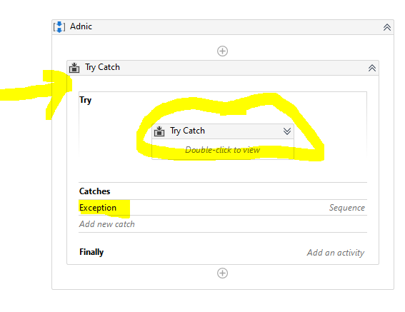

Hi Palani
Can I use Try Catch Activity inside another Try Catch.
As I have used, My exception is Try Block of Circled Marked Try Catch Activity. Now it’s printing the Catch Block Circled Try Catch Activity it’s fine.
But if we see now the exception is in Try Block of arrow marked Try Catch. So it’s Catch Block should also executing na which I marked but it’s Catch is not executing. Please tell me am I doing right?
Bcz I have to handle the multiple exception, In the same sequence. I can create multiple sequence but my Adnic sequence will be one only.
sorry bro didn’t get this ?
Now we have one try catch activity say 2 inside another main try block say 1
Now we would have included all the activities inside the try block of 2 so if any exception occurs it will get into the catch block of 2 only as we have a catch in that itself
It won’t get into the catch block of the main try catch 1
cheers @balkishan
