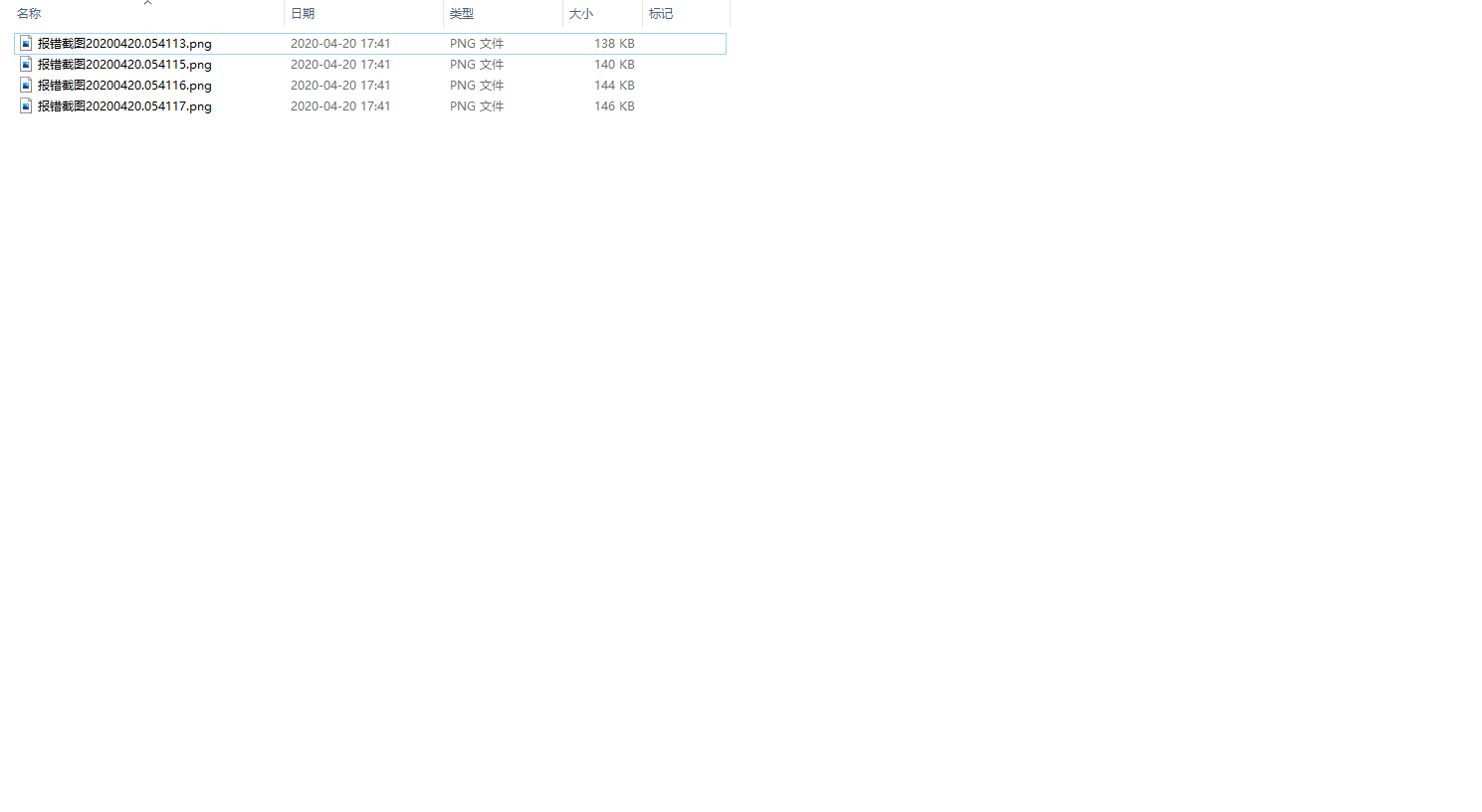

In this picture, we can see there are for error screenshot files.and I revecived 4 emails.
pls check - any retry options enable with count :slight_smile:

By default, the Global Handler template retries the exception 3 times before aborting the execution. This default behavior can be changed from inside the template.
As you have removed “Choose Next Behaviour” sequence, though it is by default retried for 3 times.
