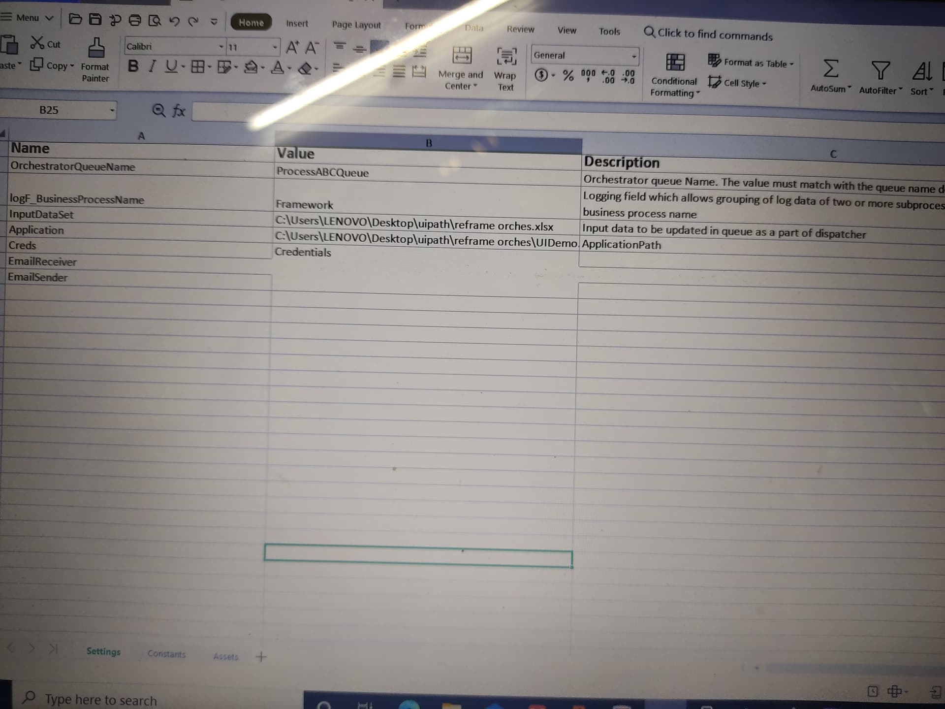

Given key is not present in dictionary
Sir why the problem is arrising
I have hidden the mail ids for security reasons

There is no space

  1. You have placed Config file in a different location.
  2. Put some value in the excel file for the Key, then try.
  3. If the cells are merged, please make it correct.
While creating dictionary key value pair make sure you have used .ToString.Trim with the key

There’s no value in the spreadsheet so maybe it isn’t creating a key for it.

  1. Name of the key is different in config file.
  2. Some spaces are included in the name which has to be trimmed.
  3. Config dictionary object that you are using is not the right one or doesn’t have anything or is not passed correctly to the sequence.
For you, looks like reason 3 to me.
Can you verify if that Config variable you are using is the right one?
Please go to InitAllSettings argument list and verify if you have saved out_config from that workflow into this Config variable or not?

I fixed my problem by the way.
The config file path was wrong.
I updated and the process worked.
