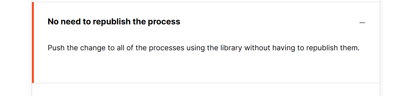

I’ll note here that the Automation Solution Architects training states, when referring to using libraries for reusable components
So it’s what UiPath say should happen, but even the mass updating tool republishes.
Personally, I’d say this should apply for patch releases and maybe minor releases, but not major ones. I would suggest that this be configurable somehow.
