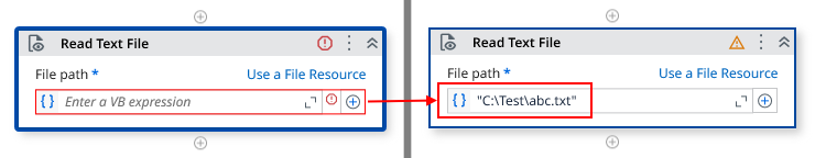

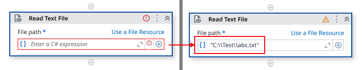

Hello @Ankola,
The standard format used by the Windows operating system to structure file paths is the backslash (\).
Considering that the file abc.txt actually exists at the path C:\Test and that there are permissions to read it, the configuration you need to apply to the Read Text File activity is as follows:
  • Project using C#: File path → "C:\\Test\\abc.txt" ← NOTE: A double backslash is used as a separator.
  • Project using VB.NET: File path → "C:\Test\abc.txt"
Below are some screenshots as examples:
I hope this helps you solve your problem.
