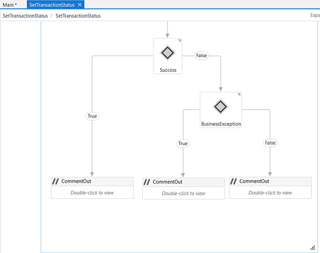

So, in Process Transaction when you finish one process you have Finally part.
In that Finally part you have Invoke SetTransactionStatus workflow .
In there you have used Comment out activity to comment out everything, so you also commented out the part where you Increment your TransactionNumber
You need only to remove the parts where it says Only if you are working with queue items and leave the rest on so the ReFramework keeps working properly.
Thanks @srdjan.suc , resolved the issue with your solution. Proceeding further. ![]()
