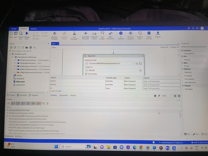

Hey @dipon1112000
you can try this solution:
BlankProcess70.zip (4.2 KB)
Thank you so much but the result is coming false for all the rows

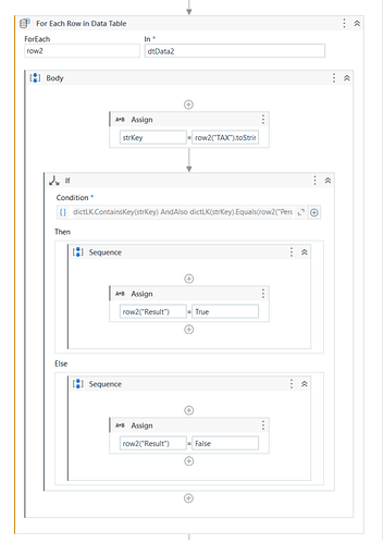

Have a look at this lookup dict approach
dictLK = Dictionary(Of String, String) =
dtData1.AsEnumerable.ToDictionary(Function (x) x(2).toString.Trim, Function (x) x("TAX_RATE").toString.Trim)
So in a second step dt1 can be extended with the status column and can be updated by using the lookup dict for the Code and cheking the rate when looping over dt2
ppr
(Peter Preuss)
January 12, 2024, 12:04pm
10
Giving some more starter help:
Preps
Check
strKey = row2(“TAX”).toString.Trim
IF Condition
dictLK.ContainsKey(strKey) AndAlso dictLK(strKey).Equals(row2(“Percent”))
We do feel:
a few corrections are to do (at least the column issue from dt1 can lead to wrong LookUpDict
maybe the Percentage precions 0.5 vs 0.5000000001 are to harmonize
Feel free to adapt and to enhance
