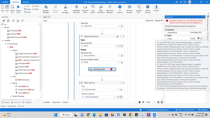

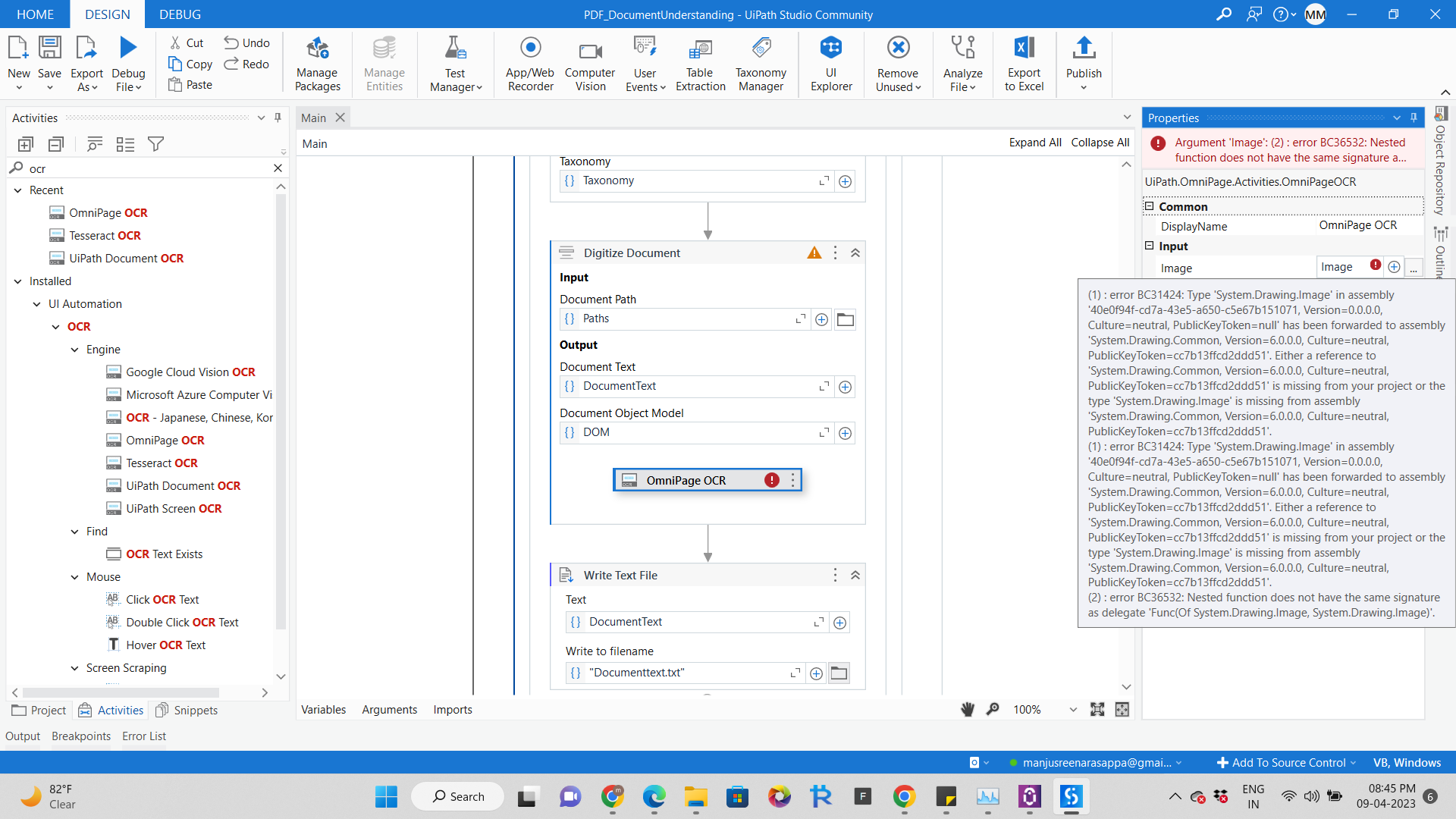

I am working on document understanding with PDF while using omnipage OCR getting below error please suggest how to resolve.
@manjusree_R_N_manju
Please delete image there and create a variable of type image and assign it…the error must go off…you can use ctrl+k as well to create variable or required type
Or just remove the image from there
Hope this helps
@Anil_G Thanks for the help issue is resolved after downgrading the version of intelligent ocr activities

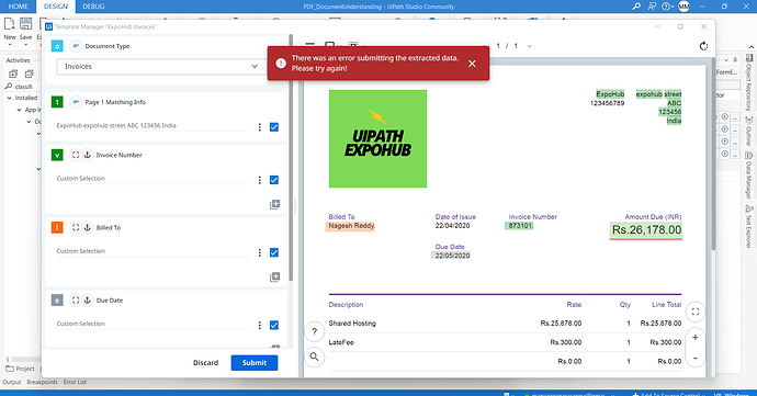

Now am getting error in Data extraction step any solution to resolve this
