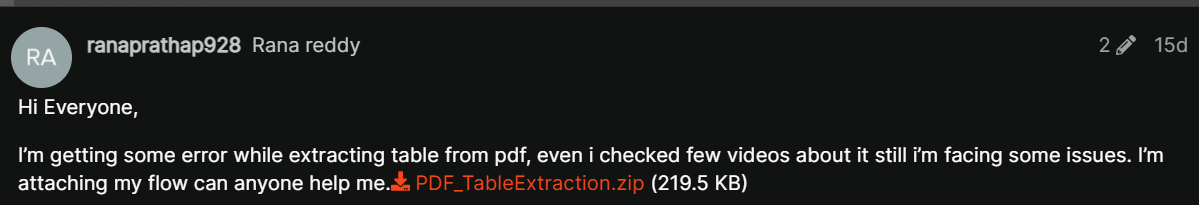

Hi Everyone,
I’m getting some error while extracting table from pdf, even i checked few videos about it still i’m facing some issues. I’m attaching my flow can anyone help me.PDF_TableExtraction.zip (219.5 KB)
