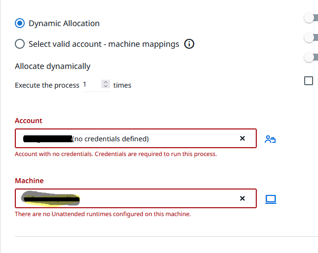

While creating Machine I am getting like this. But allows to create a machine. Once after machine created I have created a new process by assigning the same machine what I have created. Then while triggering the job getting error like this

For running in unattended while creating the robot or user you have to provide thec redentials…you did not provide i guess
and for machines as explained assign a license
First go to admin page and given licenses to tenant and then you can assign them to user and link machines and add machines and users to folders

Thats not creating a machine, thats starting a process and selecting a machine. Create a machine template and assign the licences to it, you must remove them from the classic folder first.
Make sure your robots are connecting to the orchestrator with that machine template.

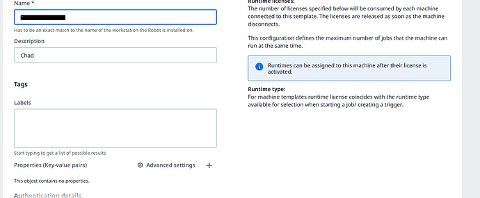

As said I have created a machine with machine template. But I am unable to assign license to it (I have only attended robot license )

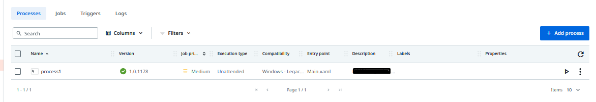

After this I have created a modern folder–>Process–>assigned machine to the process
But while starting the job it asking for account and machine.
You can’t run an unattended robot without assigning unattended licences to the machine template. Attended robots are for attended processes. Sounds like you were maybe breaking your licence terms and running an unattended robots via attended licences?

Now I have created a machine with machine template as below

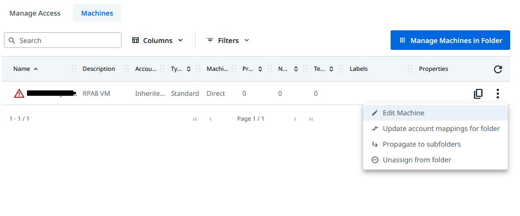

I have assigned the above created machine to the modern folder
Then I have created a new process
Now in the respective machine I am connecting the bot from assistant. But getting license error like this

On a quick look. If the user groups are set up correctly in your Cloud to distribute the available licenses, it looks like using the image button by the target attended user should resolve this warning:
I assume the goal is not to run those unattended, which won’t work here either way with just an attended license.
