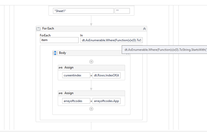

Calculating index of row which starts with T is taking more time with For each loop as i have 100 rows.how can i do this usecase efficiently.

Basically I am trying to find the T related cel values and use them as anchor till fill using auto fill range till the next T
can you explain a bit more,im not able to apply the same in UiPath.

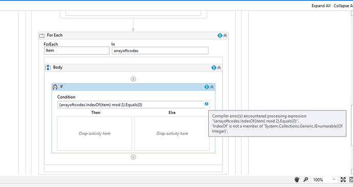

i have extracted the cell number like above and getting error in if condition
@neha.kumarief868
First of all the condition you have for where will get the roes with t …that is the reason i asked ypu to use find/replace so that you get the exact indexes…the value sthat you get are not the correct index
And I am not sure what you have in array of codes
Ideally the array should contain the cel values
i have stored index manually as of now but still it is having error.
@neha.kumarief868
Please use indexof like this
Array.IndexOf(arrofcodes,item)
Hi Anil,
Thanks for the response , but thi sline is also failing with same error message(Above one).
