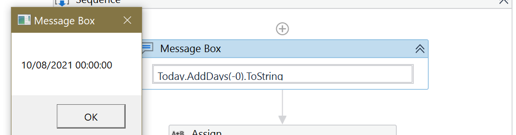

If you check below it has gives you very specify result including the time
Maybe you don’t have the results at that time
You can check below to get the today’s mails as below
Hope this may help you
Thanks
Hi
Change the condition like this
And give a try
“[ReceivedTime] > '”+now.AddDays(-(Convert.ToInt32(backDate.ToString))).Date.tostring(“dd/MM/yyyy”)+“’”
It won’t give yesterday mail and give only today’s mail
