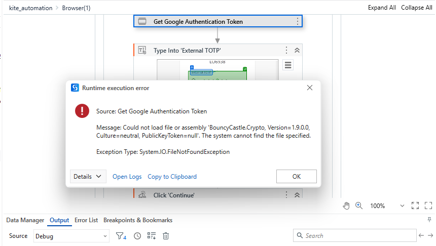

Hello,
I am trying to automate a webpage which requires google authenticator code. when I run the file I receive the error message
“message”: “Get Google Authentication Token: Could not load file or assembly ‘BouncyCastle.Crypto, Version=1.9.0.0, Culture=neutral, PublicKeyToken=null’. The system cannot find the file specified.\r\nin kite_automation(Autosaved).xaml\r\n at GetGoogleToken "Get Google Authentication Token"\r\n at Sequence "Do"\r\n at NApplicationCard "Browser(1)"\r\n at Flowchart "kite_automation"\r\n at kite_automation_Autosaved_ "kite_automation(Autosaved)"\r\n”,

I have tried to reinstall all the packages and also tried various other recommendations provided in the community, but this problem doesn’t go.
Any help would be appreciated.

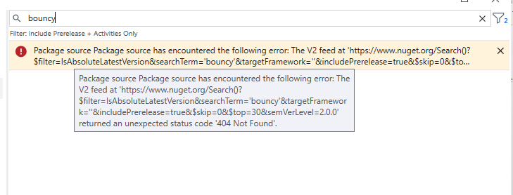

Actually I am facing this issue, maybe this is the cause and I can’t see any packages
Hi @Bhaskar_Das
Make sure you remove all the filters and search in All Packages.
Regards
Yes this worked. Finally. Thanks a lot for your suggestion.
