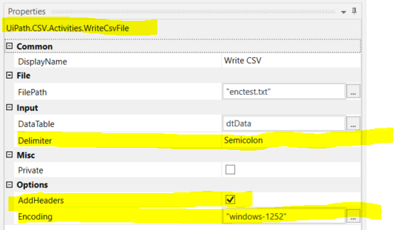

with the write csv config of:
grafik
(Kindly note: the docu link from Above mentions: Windows-1252 (Uppercase W). But only with Lowercase W the encoding is right applied
produced from:
grafik
following output:
grafik
So for text no surrounding “” was created. The delimiter was set to semicolon
