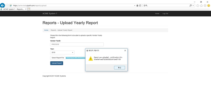

Some transactions ‘out_Uload’ are not recognized. Execution stops at the last picture. What value should I write?

I believe your selector is too specific. You could fix this one of two ways:
  1. Try using the Repair function in Selector Editor when you have the pop-up on-screen after running into this error. It will attempt to find the like elements in your current selector and the one on-screen to create a better selector for future runs.
  2. Manually remove elements of your current selector. Looking at your current selector, I would recommend perhaps unchecking “ctrlid” and seeing if that works.
Hopefully that helps!
Hello @hanbyeol
Try to use wildcards in selectors like * where you think values will change everytime you do the same steps, that will help you solve your problem i think.
Cheers!
Hi @hanbyeol
In your selector you are using **
Try using a single *
Thank you for your answer! I tried and I succeeded. <3
