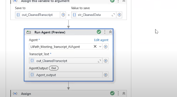

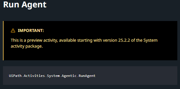

Do you know what package dependency in studio is required to see this activity for agents?
Hi @ashton.lalchan
Check this:
Activities - Run Agent
If you found helpful, tick as a solution.
Happy Automation
@ashton.lalchan
  1. For any gen ai you need 24.10+
  2. Specifically for this system activities should be 25.2+

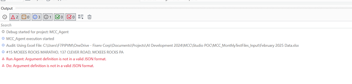

I am able to see the process, but when running the “run agent” activity, I am getting this error.
In the Agent System prompt, I have an input argument called “Business_Name” and I tried to replicate this in the “Input arguments” in the activity in studio desktop but is does not give me an output. it gives that error ^^
@prashant1603765 @Anil_G @Nitya1 help with this would be appreciated ^^
In studio, I am basically getting business_name from an excel file and passing that to the agent input, but it throws that error
Make sure the excel value is properly converted to a string (e.g: business_name.ToString.Trim()) before passing it to the agent input.
@ashton.lalchan
can you show what and how you passed please
as per error looks like there are some invalid characters like unesaped double quotes or brackets which is spoiling the format
cheers
@Anil_G @prashant1603765 @Nitya1
this is what the varibale Business_Name assigned to
String.Join(", ", New String() {CurrentRow.ByField(“DBA_Name”).StringValue, CurrentRow.ByField(“DBA_Address_Line1”).StringValue, CurrentRow.ByField(“DBA_Address_Line2”).StringValue})

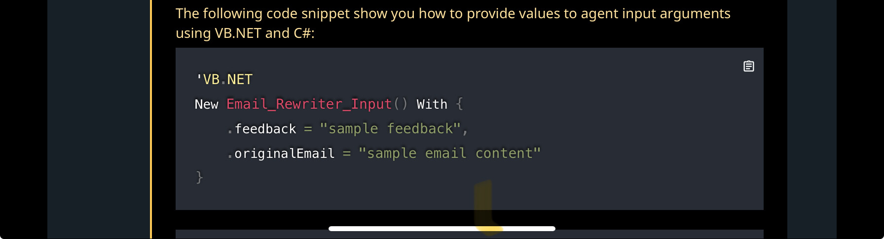

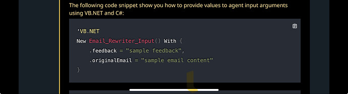

This sinhow you need to provide the input
'VB.NET
New Email_Rewriter_Input() With {
    .feedback = "sample feedback",
    .originalEmail = "sample email content"
Hi @Anil_G Im not sure how that will work, becuase I am assigning Business Name to the contatenation of the address that i get from the excel sheet. shouldnt i just pass that to the Input argument in “run agent”
