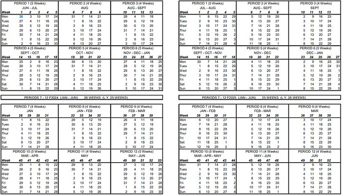

How can I build. using regex, I tried but not working
I need output as datatable

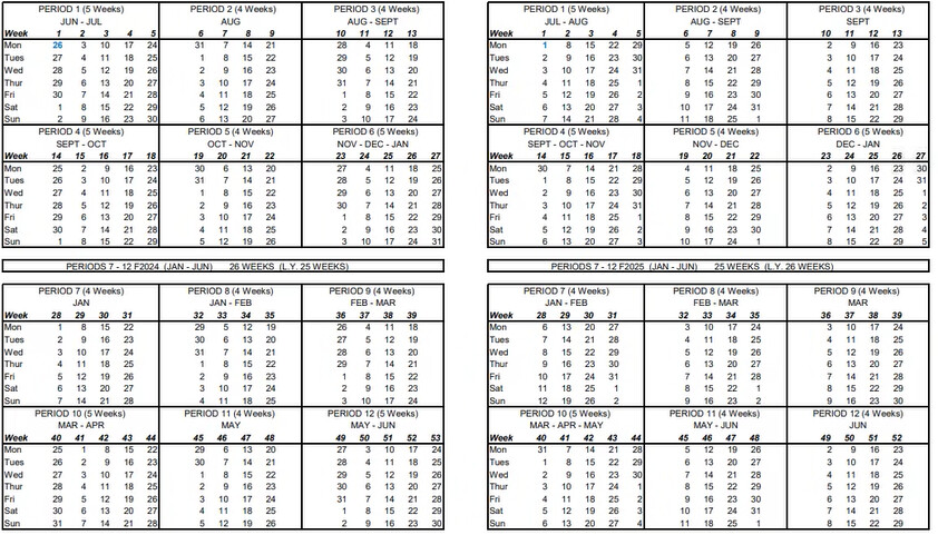

This is the input - which is in pdf
Hi @Meghana_Bonu
In that case, you can use “read pdf with OCR ” activity to read contents of the pdf.
and then use regex on that output string to fetch the details you need.

I can able to read the content from the pdf, but when I tried regex, it is unable to identity.
In first box, Period is 1 then Start Date as 26-Jun-2024 and End Date as 30-Jul-2024
In the second box, Period is 2, then Start Date as 31-Jul-2024 and End Date as 27-Aug-2024
In the third Box, Period is 3 then Start Date as 28-Aug-2024 and End Date as 24-Sep-2024 so on
@Meghana_Bonu
Try below regex:
^Period\s+(\d+)\s+([\w\s-]+)\s+(\d{1,2}-[A-Za-z]{3,4}-\d{4})\s+(\d{1,2}-[A-Za-z]{3,4}-\d{4})$
