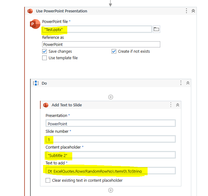

You will require UiPath.Presentations.Activities for this. Which you can download from manage packages
Read Your Excel With Quotes By Using Read Range
Create these 2 variable of Int32 type One for Total Row Count Of Quotes in excel & Other for Random Row No
Use PowerPoint Presentation Activity With Your PP file Path & Add Text To Slide for adding the quote to that particular slide.
Hi @AJ_Ask,
Can you share the zip file of the code if possible.
Thanks in advance!!
Hi @Kunal_Jain Hope this Helps :slight_smile:
Also Use 1.11.2 Version of Presentations.Activities
PowerPoint_Automation.zip (82.1 KB)
