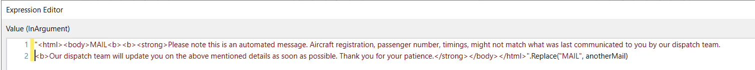

I Want to Include a Disclaimer in Bold:
Please note this is an automated message. Aircraft registration, passenger number, timings, might not match what was last communicated to you by our dispatch team.
Our dispatch team will update you on the above mentioned details as soon as possible. Thank you for your patience.
The Mail should look like:
Using a is Body Html checked with this body:
produces me:
No formatting at all.

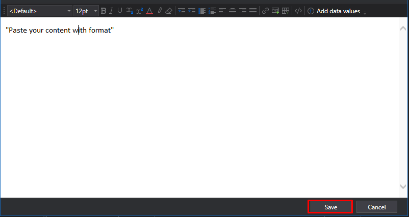

Hi @Hurmet_Noka
Try to use Create HTML Content Activity
Regards
Gokul

I did not know that this exists.
THANK YOU SO MUCH!
You saved my day.
