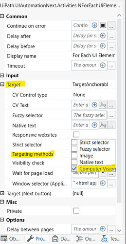

Hi @Theophilus_Timothy_Ruben
After indicating the elements by For each Ui element activity come back to studio and open the properties for that activity.
There is a option called Target expand it → Find the Targeting Methods Option → Check the Computer vision and uncheck the other options.
Hope it helps!!

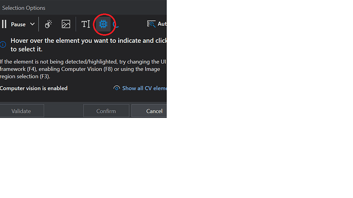

When you click on indiate you can click on cv icon on top right and then select cv check box
cheers
HI @Anil_G , Can you share a screenshot on how to select the CV on top right?
this red box
cheers
