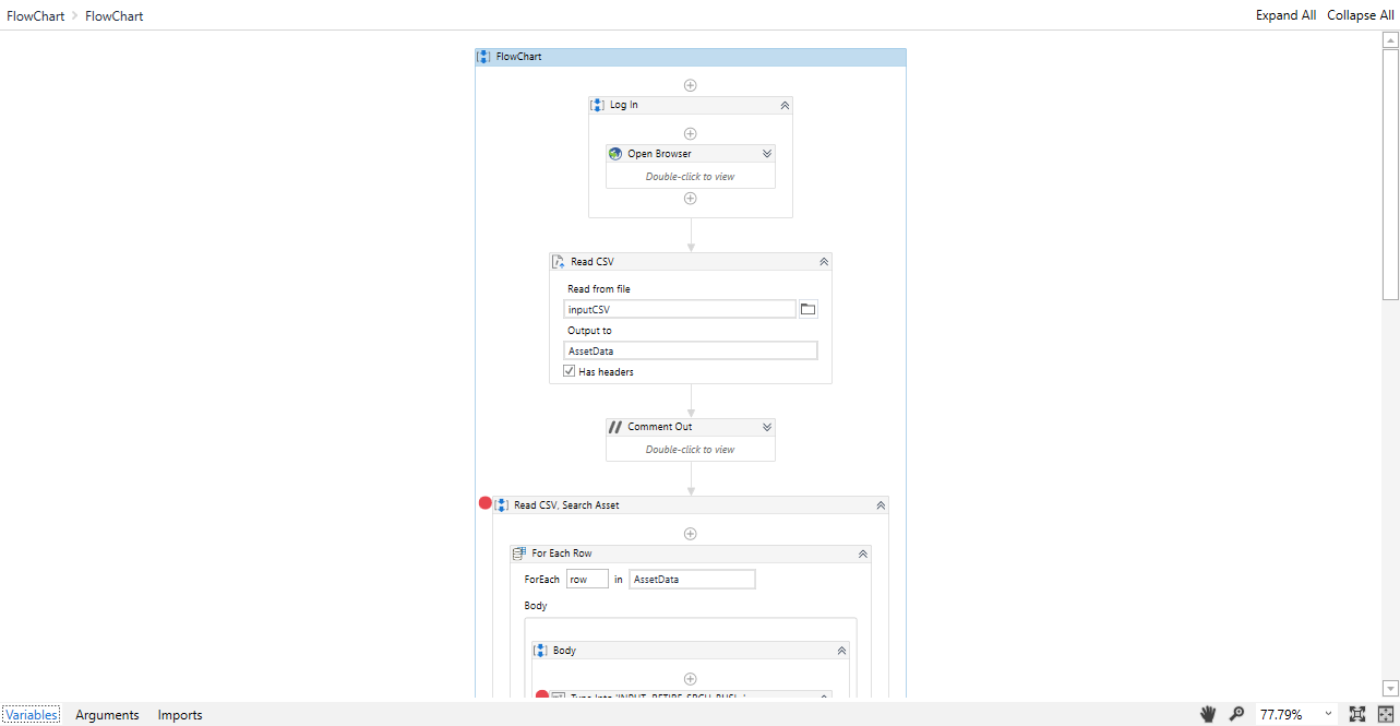

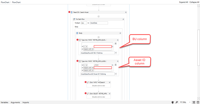

I’m using the “For Each Row” Activity in Data Studio. AssetData has 3 rows with 3 columns I need to use as I navigate two screens for each row.
I already confirmed AssetData is capturing the 3 rows by writing it to an output file.
As the execution occurs, the same first row is used 3 times.
What am I missing here?

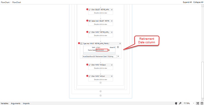

problem is in the syntax, AssetData.Rows(0)—>that means always the first row,.
You are using loop so you should write like this:
row.item(“Column Name”).toString
It worked. Thank you!
