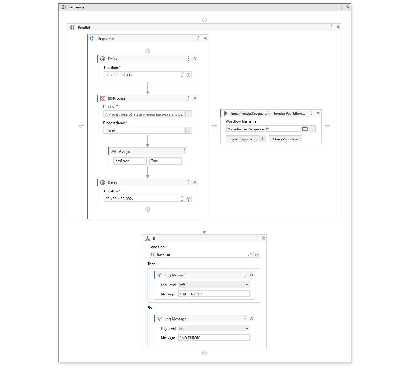

Can you try the following sample? This uses Parallel activity and InvoekWorkflowFile with Isolated option.
Sample20230331-2L.zip (14.2 KB)
Please turn on ContinueOnException in ribbon menu if run debug mode.

Hi, thank you for your advice!
I tried the sample you gave, however, I was wondering how I could determine if excel was indeed stuck. Is it safe to assume that once the flow passes the Kill Process, then it’s stuck?
We can judge it to be stuck when it much exceeds the time it would normally finish, I think. So it’s necessary to set delay time proper duration.
