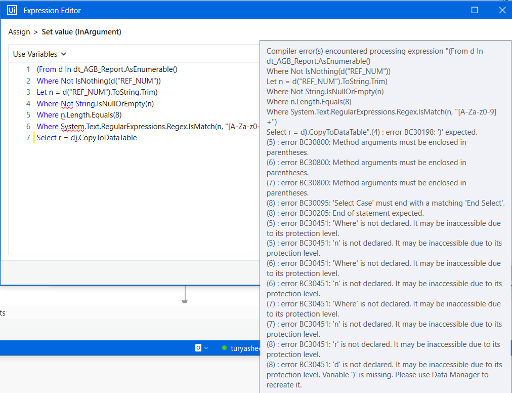

We do feel that with a combination of Regex / StringCheck and LINQ we can do like
Assign Activity (valid Rows DT)
dtValidRows =
(From d In yourDataTableVar.AsEnumerable()
Where Not isNothing(d("YourColName"))
Let n = d("YourColName").toString.Trim
Where Not String.IsNullOrEmpty(n)
Where n.Length.Equals(8)
Where System.Text.RegularExpressions.Regex.isMatch(n,"[A-Za-z0-9]+")
Select r = d).CopyToDataTable
Assign Activity (invalid Rows DT)
dtInvalidRows =
yourDataTableVar.AsEnumerable.Except(dtValidRows.AsEnumerable, DataRowComparer.Default ).CopyToDataTable

I am still new to studio, :sweat_smile:here are the errors I get
we corrected the LINQ as a closing bracket was missplaced
Provided LINQ is in VB.Net Language
