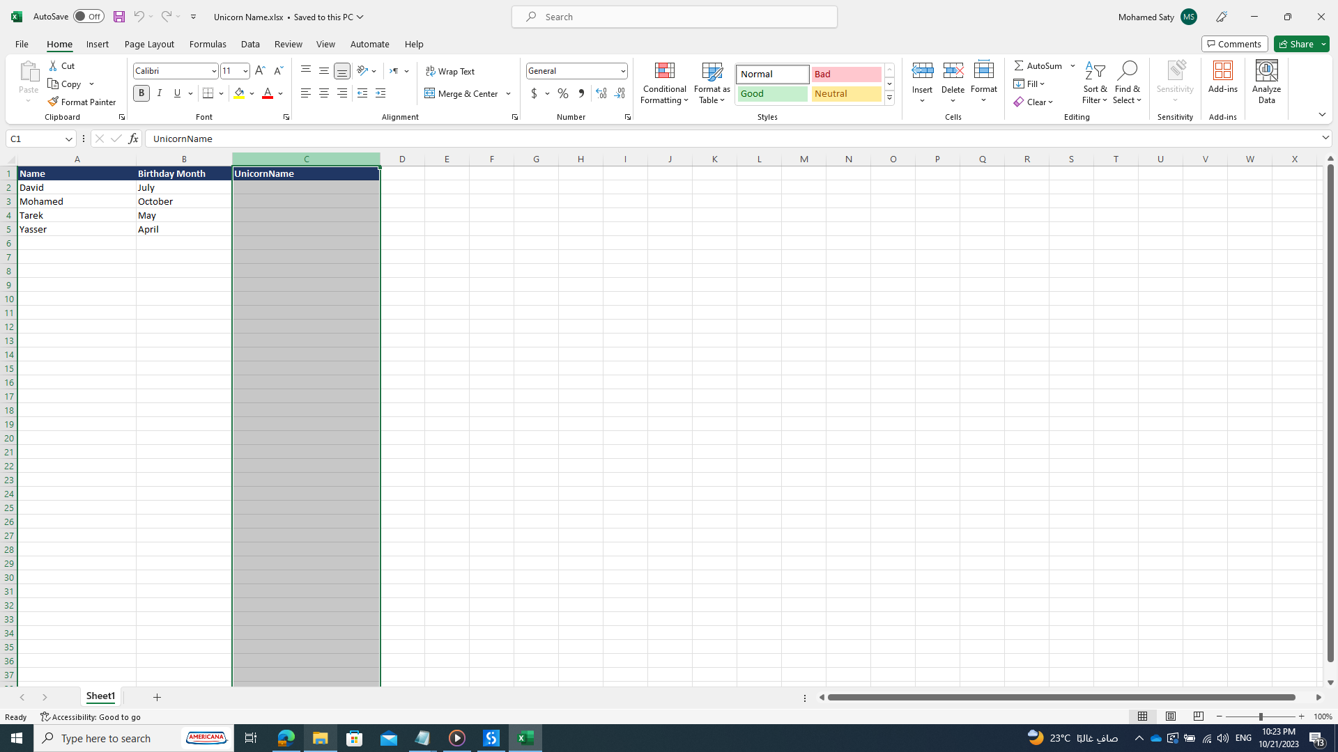

At UiPath course they give an example for how to create unicorn name only for on user. i have managed to create a unicorn name for many names. but i need to take the unicorn names for those users and insert them to the same excel sheet in a new column.

thanks this worked fine, but not the same way i wanted.
i want to take only the unicorn name and add it to the same excel file in the Unicorn name column.
this created a new excel file. is there a way to do it.

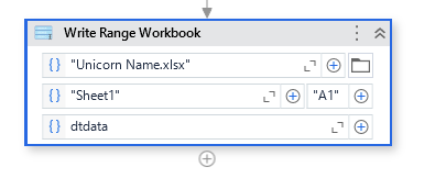

If you want to write the data in the same excel and sheet then give the details as below
Hope this helps!!
Just overwrite the file as the following.
